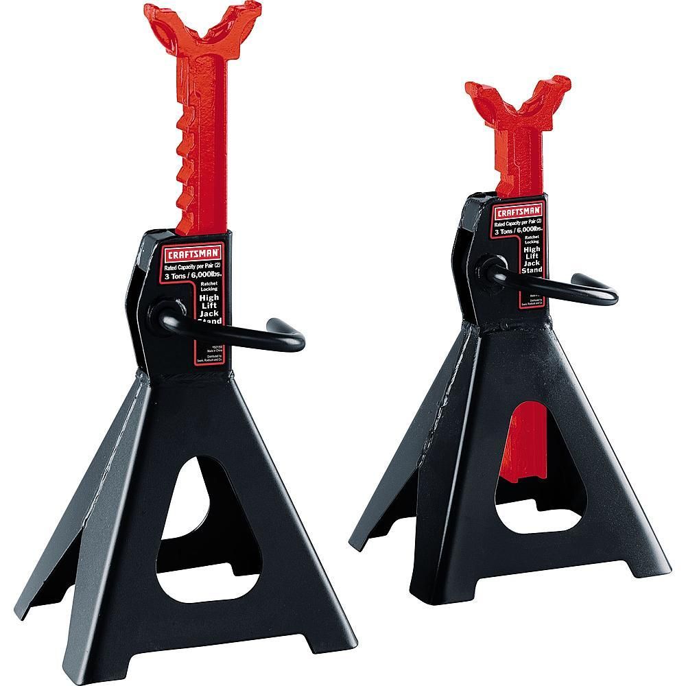

  18. madhatter
    madhatter New Member
    This is great and all, but what if you want to raise the car and put it on jack stands? If you lift at the factory recommended lift points, where do you put the jackstand once the car is in the air?
    Pokey likes this.
  19. McRib 1s Back
    McRib 1s Back Well-Known Member
    Great point! I'm only doing this for field-expedient track-side wheel changes! :)
  20. reddog99
    reddog99 Active Member
    On the front, I use the bolt heads that fasten the engine sub-frame.
    On the rear I use the frame that acts as the anchor for the swing-arm pivot point.
